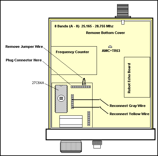

Remove the bottom cover from the unit and locate the Selector board just behind the Channel Selector. Unsolder and remove the short jumper wire on the rear of the Selector Board as shown above.
2. Locate the loose ends of the Gray and Yellow wires coming from the center plug on the Selector Board and Re-Solder them back together. Be sure to use Heat Shrink tubing or any suitable type of insulating material.
3. Locate the small keyed connector plug hanging loose near the Selector Board and plug it back into it's socket as shown in the Diagram above (Purple Wire on the Left).
