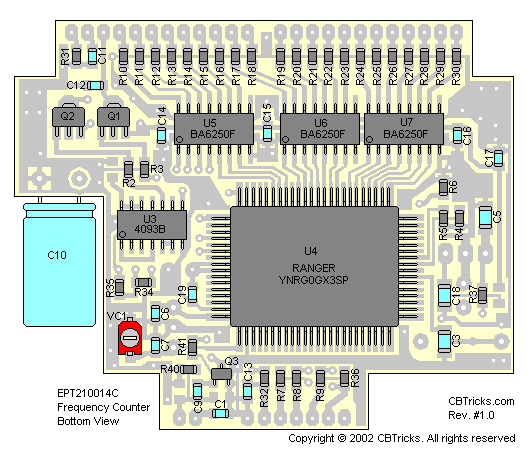

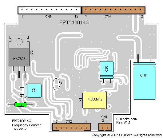

Frequency Counter PCB (EPT210014C)
EPT210014C Trace Layouts
