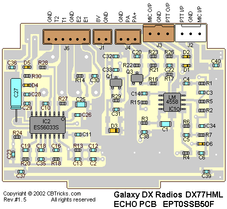

Galaxy
DX Radios DX77HML
Echo
PCB (EPT0SSB50F) Board Layout
Trace Layout
