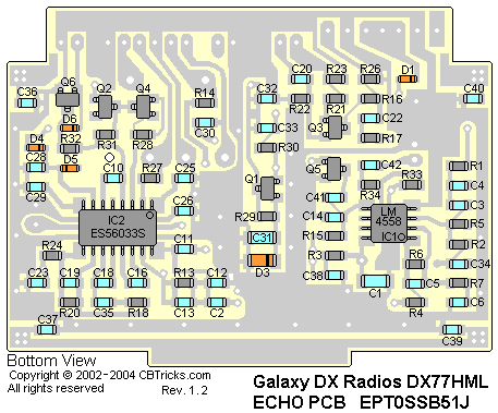

Galaxy
DX Radios DX77HML
Documentation Project
CBTricks.com
Echo
PCB (EPT0SSB51J) Board Layout
Trace Layout
Schematic Diagram
Schematic Diagram
Ref. No. |
Description |
MFR. Part No. |
EB-2000B EPT0SSB51J Complete with Components |
#T-140H-P13
EB-2000B P.C.B. 62x46x1.6tmm(d) |
EPT0SSB51J
