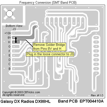

Frequency Conversion For (EPT004410A SMT Band PCB)
Export Frequency Conversion
1.
Remove the bottom cover from the unit and locate the frequency divider circuit board on the left side of the unit. Remove the screw holding the board and plug in the loose connector to J3 of the frequency divider circuit board.
2.
Unsolder and remove the solder bridge from pins 8V and H on the bottom of the pcb as shown in the diagram above, and re-mount the board back in place.
