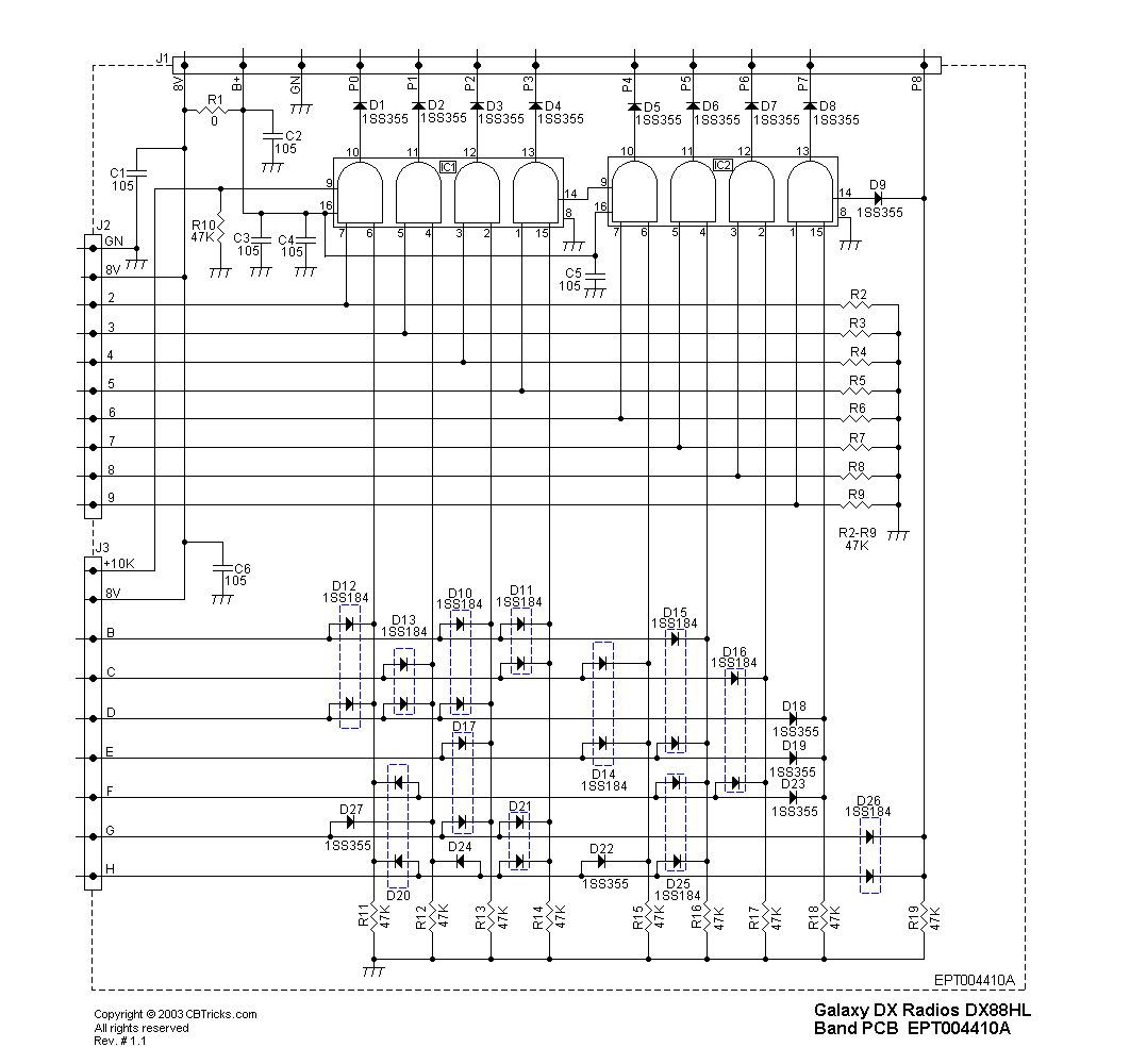

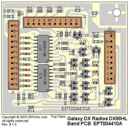

Galaxy
DX Radios DX88HL
Band Board Layout (EPT004410A)
Trace Layout
Ref#
Description |
MFR.
Part No.
BAND PCB EPT004410A |
#MM-104T-P06 |
BAND P.C.B. 46x41x1.6tmm(S) |
EPT004410A |
Resistors
Ref#
Description |
MFR.
Part No.
R1 |
CHIP/F/R (SMD) 0 OHM 0.1W |
RCY010004Z |
R2 |
CHIP/F/R (SMD) 47K OHM 0.1W |
RCY014734Z |
R3 |
RCY014734Z |
R4 |
RCY014734Z |
R5 |
RCY014734Z |
R6 |
RCY014734Z |
R7 |
RCY014734Z |
R8 |
RCY014734Z |
R9 |
RCY014734Z |
R10 |
RCY014734Z |
R11 |
RCY014734Z |
R12 |
RCY014734Z |
R13 |
RCY014734Z |
R14 |
RCY014734Z |
R15 |
RCY014734Z |
R16 |
RCY014734Z |
R17 |
RCY014734Z |
R18 |
RCY014734Z |
R19 |
RCY014734Z |
Capacitors
Ref#
Description |
MFR.
Part No.
C1 |
CHIP/C (SMD) 1UF 16WV Z Y5V |
CK5105AB7R |
C2 |
CK5105AB7R |
C3 |
CK5105AB7R |
C4 |
CK5105AB7R |
C5 |
CK5105AB7R |
C6 |
CK5105AB7R |
C7 |
CHIP/C (SMD) 0.1UF 25WV Z Y5V |
CK2104AB7R |
Integrated Circuits
Ref#
Description |
MFR.
Part No.
IC1 |
I.C. (SMD) MC14008BDR2(16PIN) |
YNMC14008D |
IC2 |
YNMC14008D |
Diodes
Ref#
Description |
MFR.
Part No.
D1 |
DIODE (SMD) 1SS355 |
EDSS00355Y |
D2 |
EDSS00355Y |
D3 |
EDSS00355Y |
D4 |
EDSS00355Y |
D5 |
EDSS00355Y |
D6 |
EDSS00355Y |
D7 |
EDSS00355Y |
D8 |
EDSS00355Y |
D9 |
EDSS00355Y |
D10 |
DIODE (SMD) 1SS184-TE85L |
EDSS00184Y |
D11 |
EDSS00184Y |
D12 |
EDSS00184Y |
D13 |
EDSS00184Y |
D14 |
EDSS00184Y |
D15 |
EDSS00184Y |
D16 |
EDSS00184Y |
D17 |
EDSS00184Y |
D18 |
EDSS00355Y |
D19 |
EDSS00355Y |
D20 |
EDSS00184Y |
D21 |
EDSS00184Y |
D22 |
EDSS00355Y |
D23 |
EDSS00355Y |
D24 |
EDSS00355Y |
D25 |
EDSS00184Y |
D26 |
EDSS00184Y |
D27 |
EDSS00355Y |
Connectors
Ref#
Description |
MFR.
Part No.
J1 |
PCB CONNECTOR/S 12P PH=2 |
EX07N48150 |
J1 |
WIRE CONNECTOR/H 12P L=160mm PH=2mm |
EX07N49280 |
J2 |
PCB CONNECTOR/S 10P PH=2 |
EX07N48209 |
J2 |
WIRE CONNECTOR/H 10P-9P L=150 2.5/2 |
EX07N49273 |
J3 |
PCB CONNECTOR/S 9P PH=2 |
EX07N48543 |
J3 |
WIRE CONNECTOR/H 9P PH=2mm L=290mm |
EX07N49281 |
Hardware
Ref#
Description |
MFR.
Part No.
PCB BRACKET |
MT3001010S |
BAND BRACKET(1) |
SET SCREW M3x0.5Px6 |
JS053006MN |
BAND PCB(1) |
SET SCREW T3x8-2 STEEL |
JS013008TH |
