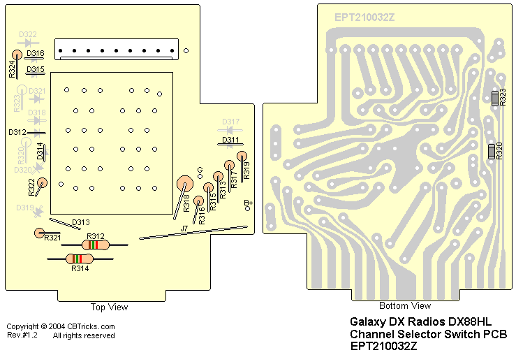

Galaxy
DX Radios DX88HL
Channel Selector Switch
PCB Layout (EPT210032Z)
Trace Layout
R209
Ref#
Description |
MFR.
Part No.
CH SW P.C.B. EPT210032Z |
#MT-115-P04 |
ROTARY SW P.C.B. |
EPT210032Z |
Resistors
Ref#
Description |
MFR.
Part No.
R312 |
C/F/R 1.5K OHM 1/4W M |
RCM141524B |
R313 |
C/F/R F-TYPE 1.5K OHM 1/4W U |
RCU141524Z |
R314 |
RCM141524B |
R315 |
RCU141524Z |
R316 |
RCU141524Z |
R317 |
RCU141524Z |
R318 |
C/F/R P-TYPE 820 OHM 1/2W P |
RCP128214Z |
R319 |
RCU141524Z |
R320 |
CHIP/F/R (SMD) 1.5K OHM 0.1W |
RCY011524Z |
R321 |
RCU141524Z |
R322 |
RCU141524Z |
R323 |
RCY011524Z |
R324 |
RCU141524Z |
Switch
Ref#
Description |
MFR.
Part No.
ROTARY SW GPS-0501 |
EWRT32000S |
Jumpers
Ref#
Description |
MFR.
Part No.
D311 |
JUMPER WIRE 7x3x7mm |
WX01070703 |
D312 |
WX01070703 |
D313 |
JUMPER WIRE 7x5x7 |
WX01070705 |
D314 |
WX01070703 |
D315 |
WX01070703 |
D316 |
WX01070703 |
J7 |
JUMPER WIRE 7x20x7mm |
WX01070720 |
Connectors
Ref#
Description |
MFR.
Part No.
PCB CONNECTOR/S 9P T PH=2.5(WHITE) |
EX07N48083 |
