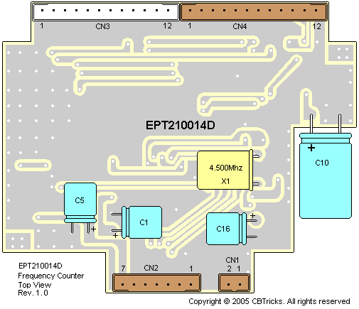

Galaxy DX Radios DX88HL
Frequency Counter PCB (EPT210014D) (Started with later 2005 Production)
EPT210014D Trace Layouts
Ref#
Description
MFR. Part No.
EPT210014D Counter PCB Complete with Components.
#T-118J1-P03
COUNTER P.C.B.  162x51x1.6tmm(d)
EPT210014D
