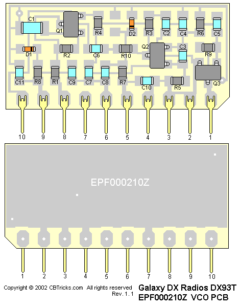

Galaxy
DX Radios DX93T
MODULAR
VCO P.C.B. (EPF000210Z)
Trace
Layout
Schematic
Resistors
Ref#
Description |
MFR.
Part No.
R1 |
CHIP/F/R (SMD) 10 OHM 0.1W |
RCY011004Z |
R2 |
CHIP/F/R (SMD) 10K OHM 0.1W |
RCY011034Z |
R3 |
CHIP/F/R (SMD) 100 OHM 0.1W |
RCY011014Z |
R4 |
RCY011034Z |
R5 |
RCY011034Z |
R6 |
CHIP/F/R (SMD) 560 OHM 0.1W |
RCY015614Z |
R7 |
RCY011034Z |
R8 |
CHIP/F/R (SMD) 47K OHM 0.1W |
RCY014734Z |
R9 |
CHIP/F/R (SMD) 220K OHM 0.1W |
RCY012244Z |
R10 |
RCY011004Z |
Capacitors
Ref#
Description |
MFR.
Part No.
C1 |
T/C(SMD) 'A'CASE 1UF 16WV M |
CTY161056Z |
C2 |
CHIP/C (SMD) 0.01UF 50WV K X7R |
CK1103AB5X |
C3 |
CHIP/C (SMD) 220PF 50WV K UJ K CH |
CK1221AB5G |
C4 |
CHIP/C (SMD) 180PF 50WV K SL K CH |
CK1181AB5L |
C5 |
CHIP/C (SMD) 10PF 50WV D CH |
CK1100AB2A |
C6 |
CK1100AB2A |
C7 |
CHIP/C (SMD) 18PF 50WV J CH |
CK1180AB4A |
C8 |
CHIP/C (SMD) 470PF 50WV K CH |
CK1471AB5A |
C9 |
CHIP/C (SMD) 5PF 50WV C SL CH |
CK1050AB1L |
C10 |
CHIP/C (SMD) 0.001UF 50WV K X7R |
CK1102AB5X |
C11 |
CK1102AB5X |
Transistors
Ref#
Description |
MFR.
Part No.
Q1 |
TRANSISTOR (SMD) 2SC2712GR-TE85L |
TY2SC2712G |
Q2 |
TRANSISTOR (SMD) 2SC3123 -TE85L |
TY2SC3123Z |
Q3 |
TY2SC3123Z |
Diodes
Ref#
Description |
MFR.
Part No.
D1 |
DIODE (SMD) 1SV214 -TP |
ED1V00214Y |
D2 |
DIODE (SMD) HVU359 |
EDHU00359Y |
Hardware
Ref#
Description |
MFR.
Part No.
IC PIN 022-1.0-S(WAKO) |
GZZZ50098Z |
