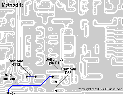

First, remove power to the radio. Remove the bottom chassis cover of the radio.
2.
Remove R113 and D68 as shown above.
3.
Connect a jumper wire between +8V and J9 pin F1.
4.
Perform an PLL alignment as shown below.
