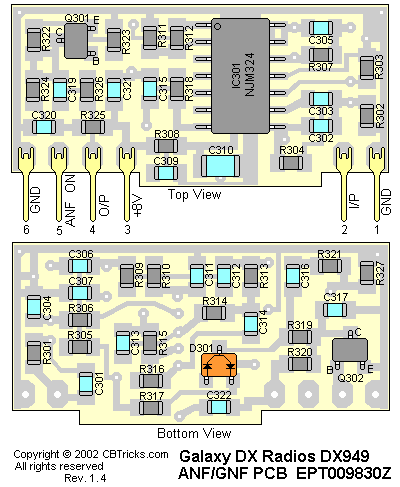

Galaxy
DX Radios DX949
ANF/GNF P.C.B. (EPT009830Z)
Trace
Layout
Ref.
No.
Description |
MFR.
Part No.
ANF/GNF P.C.B. ALSN-98 |
EPT009830Z
ANF/GNF P.C.B. Complete with Components |
#MH-590-P03 |
Ref.
No.
Description |
MFR.
Part No.
R301 |
CHIP/F/R (SMD) 47K OHM 0.1W |
RCY014734Z |
R302 |
RCY014734Z |
R303 |
CHIP/F/R (SMD) 100K OHM 0.1W |
RCY011044Z |
R304 |
RCY011044Z |
R305 |
CHIP/F/R (SMD) 15K OHM 0.1W |
RCY011534Z |
R306 |
RCY011044Z |
R307 |
RCY011534Z |
R308 |
CHIP/F/R (SMD) 100 OHM 0.1W |
RCY011014Z |
R309 |
CHIP/F/R (SMD) 10K OHM 0.1W |
RCY011034Z |
R310 |
RCY011034Z |
R311 |
RCY011034Z |
R312 |
CHIP/F/R (SMD) 10 OHM 0.1W |
RCY011004Z |
R313 |
RCY011034Z |
R314 |
RCY011034Z |
R315 |
RCY011034Z |
R316 |
CHIP/F/R (SMD) 270 OHM 0.1W |
RCY012714Z |
R317 |
RCY011534Z |
R318 |
RCY011034Z |
R319 |
RCY011034Z |
R320 |
RCY011034Z |
R321 |
RCY011034Z |
R322 |
RCY011044Z |
R323 |
CHIP/F/R (SMD) 2.2K OHM 0.1W |
RCY012224Z |
R324 |
CHIP/F/R (SMD) 4.7K OHM 0.1W |
RCY014724Z |
R325 |
CHIP/F/R (SMD) 1K OHM 0.1W |
RCY011024Z |
R326 |
RCY011034Z |
R327 |
RCY014734Z |
Ref.
No.
Description |
MFR.
Part No.
C301 |
CHIP/C (SMD) 560PF 50WV K SL |
CK1561AB5L |
C302 |
CHIP/C (SMD) 100PF 50WV K SL |
CK1101AB5L |
C303 |
CHIP/C (SMD) 0.022UF 50WV Z Y5V |
CK1223AB7R |
C304 |
CHIP/C (SMD) 0.1UF 25WV Z Y5V |
CK2104AB7R |
C305 |
CHIP/C (SMD) .0047UF 50WV K X7R |
CK1472AB5X |
C306 |
CK1472AB5X |
C307 |
CK1561AB5L |
C309 |
CHIP/C (SMD) 0.01UF 50WV M Z5U |
CK1103AB6U |
C310 |
T/C (SMD) 4.7UF 16WV M |
CTY164756Z |
C311 |
CK1103AB6U |
C312 |
CHIP/C (SMD) 0.047UF 50WV Z F |
CK1473AB7R |
C313 |
CHIP/C (SMD) 0.0033UF 50WV Z Y5 |
CK1332AB7R |
C314 |
CK1473AB7R |
C315 |
CHIP/C (SMD) 0.033UF 50WV M Z5U |
CK1333AB6U |
C316 |
CK2104AB7R |
C317 |
CK1103AB6U |
C319 |
CK2104AB7R |
C320 |
CK2104AB7R |
C321 |
CK1103AB6U |
C322 |
CK1103AB6U |
Ref.
No.
Description |
MFR.
Part No.
IC301 |
I.C. (SMD) NJM324M 14PIN |
YNJR00324M |
Ref.
No.
Description |
MFR.
Part No.
Q301 |
T/R (SMD) 2SC2712GR-TE85L |
TY2SC2712G |
Q302 |
T/R (SMD) RN1403-TE85L |
TYZRN1403Z |
Ref.
No.
Description |
MFR.
Part No.
D301 |
DIODE (SMD) 1SS226-TE85L |
EDSS00226Y |
Ref.
No.
Description |
MFR.
Part No.
IC PIN |
022-1.O-S(WAKO) |
GZZZ50098Z |
