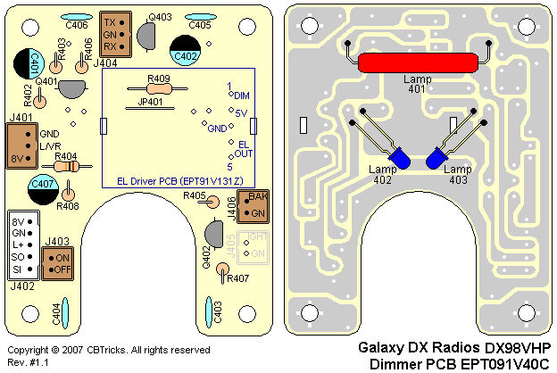

Galaxy
DX Radios DX94HP
Documentation Project
CBTricks.com
Dimmer
PCB (EPT091V40C)
Trace
Layout
Schematic Diagram
Parts List
Ref#
Description |
MFR.
Part No.
DIMMER PCB (DX-98VHP)� EPT091V40C |
#T-149E-P04 |
EPT091V40C |
EPT091V40C |
