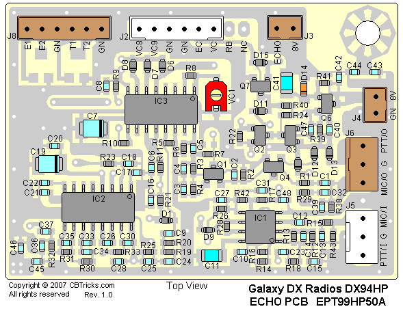

Galaxy
DX Radios DX94HP
ECHO PCB (EPT99HP50A)
Trace Layout
Ref#
Description |
MFR.
Part No.
EVRP ECHO (DX-94HP) EPT99HP50A |
#T-149D-P06 |
EPT99HP50A |
