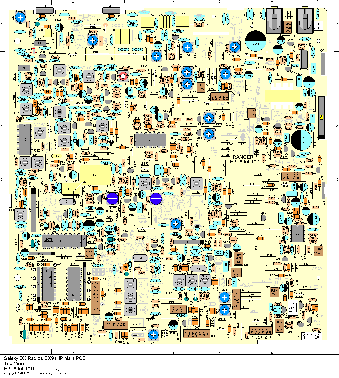

    Main PCB Parts Layout Top View

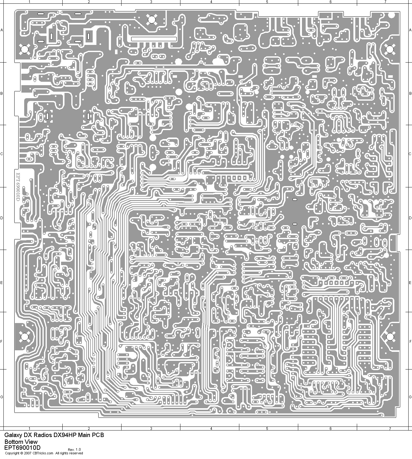

    Main PCB Copper Side View

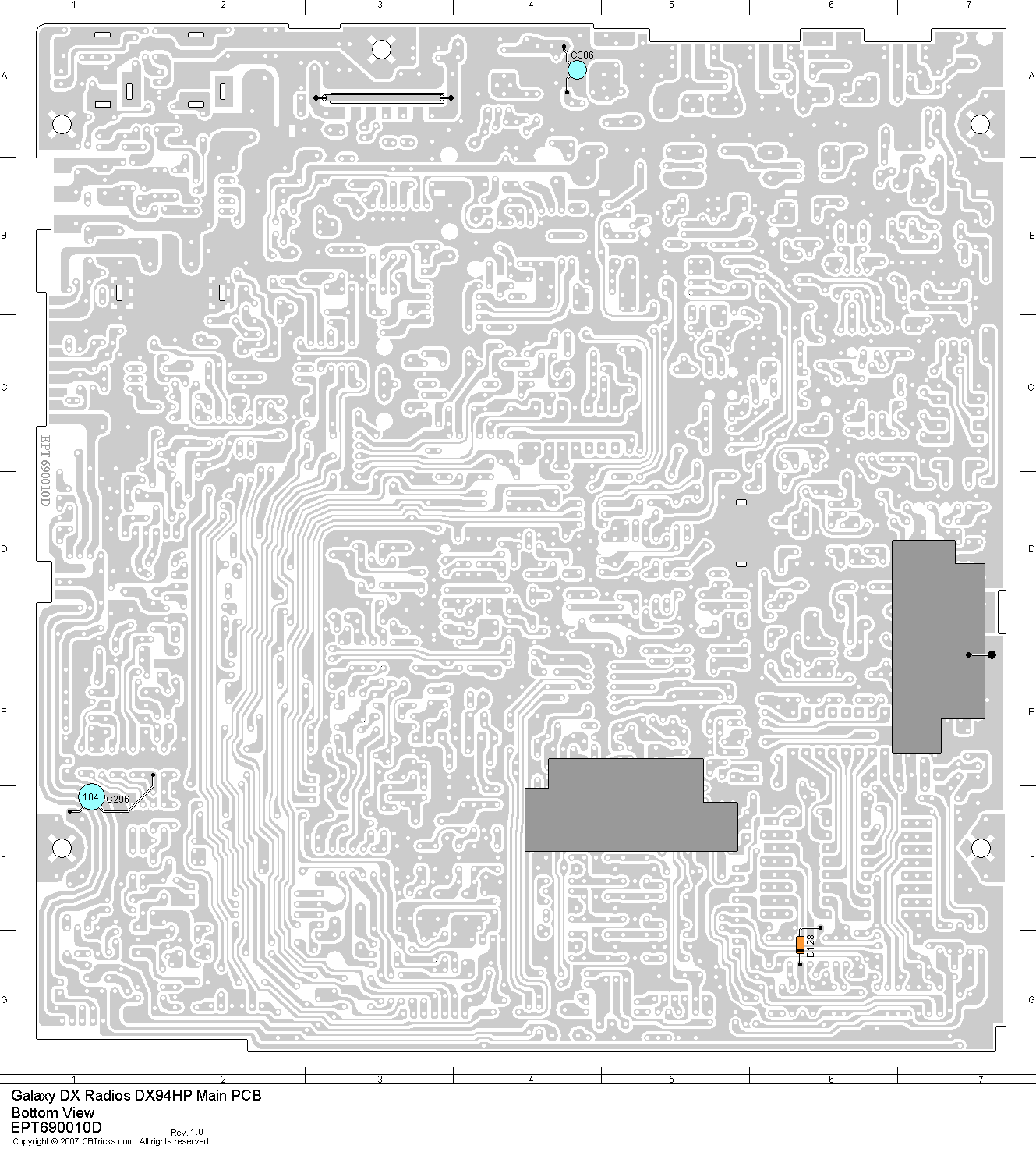

    Main PCB Parts Layout Bottom View
