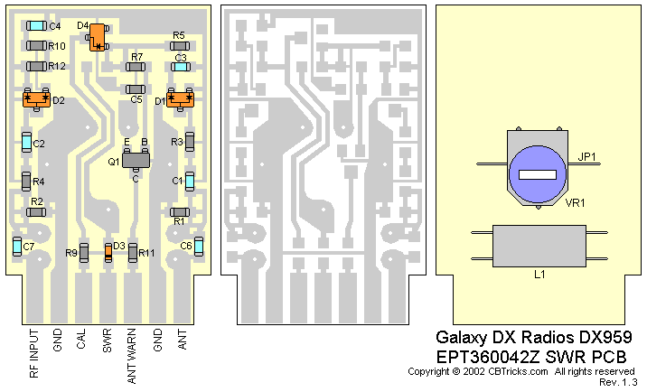

Galaxy
DX Radios DX959
SWR
P.C.B. (EPT360042Z)
Schematic
Ref.
No.
Description |
MFR.
Part No.
SWR P.C.B. 33x25x1.6tmm(S) |
EPT360042Z |
SWR P.C.B. Complete with Components |
#MT-120Q-1 |
Ref.
No.
Description |
MFR.
Part No.
R1 |
CHIP/F/R (SMD) 470 OHM 0.1W |
RCY014714Z |
R2 |
CHIP/F/R (SMD) 330 OHM 0.1W |
RCY013314Z |
R3 |
CHIP/F/R (SMD) 100 OHM 0.1W |
RCY011014Z |
R4 |
RCY011014Z |
R5 |
CHIP/F/R (SMD) 1K OHM 0.1W |
RCY011024Z |
R7 |
CHIP/F/R (SMD) 10K OHM 0.1W |
RCY011034Z |
R9 |
CHIP/F/R (SMD) 0 OHM 0.1W |
RCY010004Z |
R10 |
CHIP/F/R (SMD) 2.2K OHM 0.1W |
RCY012224Z |
R11 |
RCY011024Z |
R12 |
RCY012224Z |
Ref.
No.
Description |
MFR.
Part No.
C1 |
CHIP/C (SMD) 0.001UF 50WV Z SL |
CK1102AB7L |
C2 |
CK1102AB7L |
C3 |
CHIP/C (SMD) 0.1UF 25WV Z Y5V |
CK2104AB7R |
C4 |
CK2104AB7R |
C5 |
CHIP/F/R (SMD) 22K OHM 0.1W |
RCY012234Z |
C6 |
CHIP/C (SMD) 3PF 50WV C CH |
CK1030AB1A |
C7 |
CHIP/C (SMD) 0.5PF 50WV C CH |
CK1059AB1A |
Ref.
No.
Description |
MFR.
Part No.
Q1 |
T/R(SMD) 2SC2712GR-TE85L |
TY2SC2712G |
Ref.
No.
Description |
MFR.
Part No.
D1 |
DIODE (SMD) HSM198S |
EDHM0198SY |
D2 |
EDHM0198SY |
D3 |
DIODE (SMD) 1SS355 |
EDSS00355Y |
D4 |
DIODE (SMD) MA28T |
EDMA0028TY |
Ref.
No.
Description |
MFR.
Part No.
L1 |
TDK BRAND CORE C3RH0610 |
ECRFZ10053 |
Ref.
No.
Description |
MFR.
Part No.
VR1 |
S/F/R 10K OHM L |
RE10300009 |
Ref.
No.
Description |
MFR.
Part No.
JP1 |
JUMPER WIRE 7x15x7 |
WX01070715 |
Ref.
No.
Description |
MFR.
Part No.
SWR P.C.B. |
FOAM 14x16x20mm |
XZZZ90004Z |
