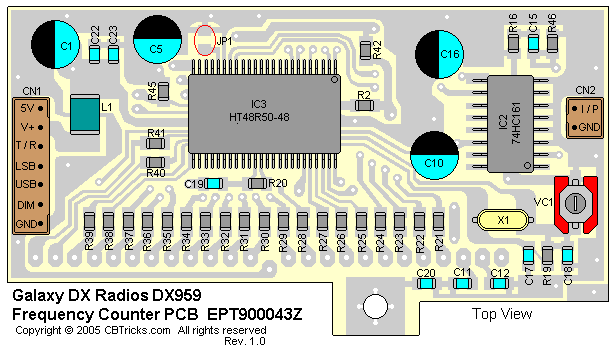

Galaxy
DX Radios DX959
Documentation Project
CBTricks.com
Frequency
Counter PCB (EPT900043Z) (Started with 2005 Production)
Trace
Layout
Schematic Diagram
(Mar. 04, 2005)
