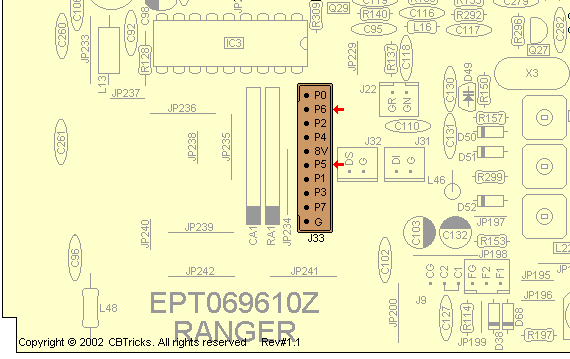

Remove bottom cover from radio.
2.
On the main PCB, locate J33. (See diagram above)
3.
Locate wires on pins marked "P5" (yellow) & "P6" (grey).
4.
Cut wire on "P5" (yellow) and install a SPST switch in line.
5.
Cut wire on "P6" (grey) and install a SPST switch in line.
NOTE:
By using two of the function switches available on the radio will eliminate the need for two new switches to be installed and mounted.
