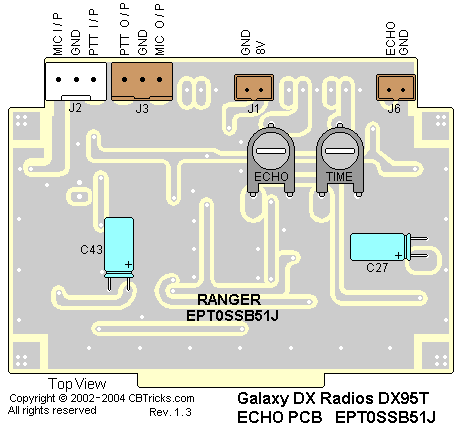

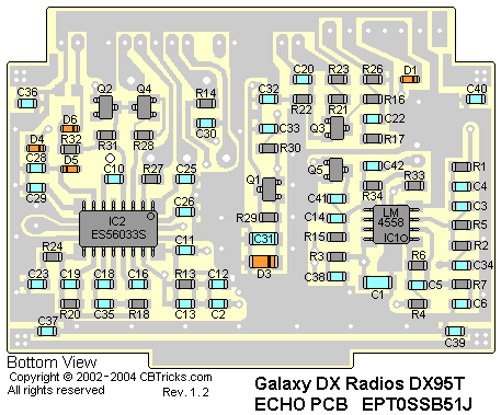

ECHO PCB (EPT0SSB51J)
Trace Layout

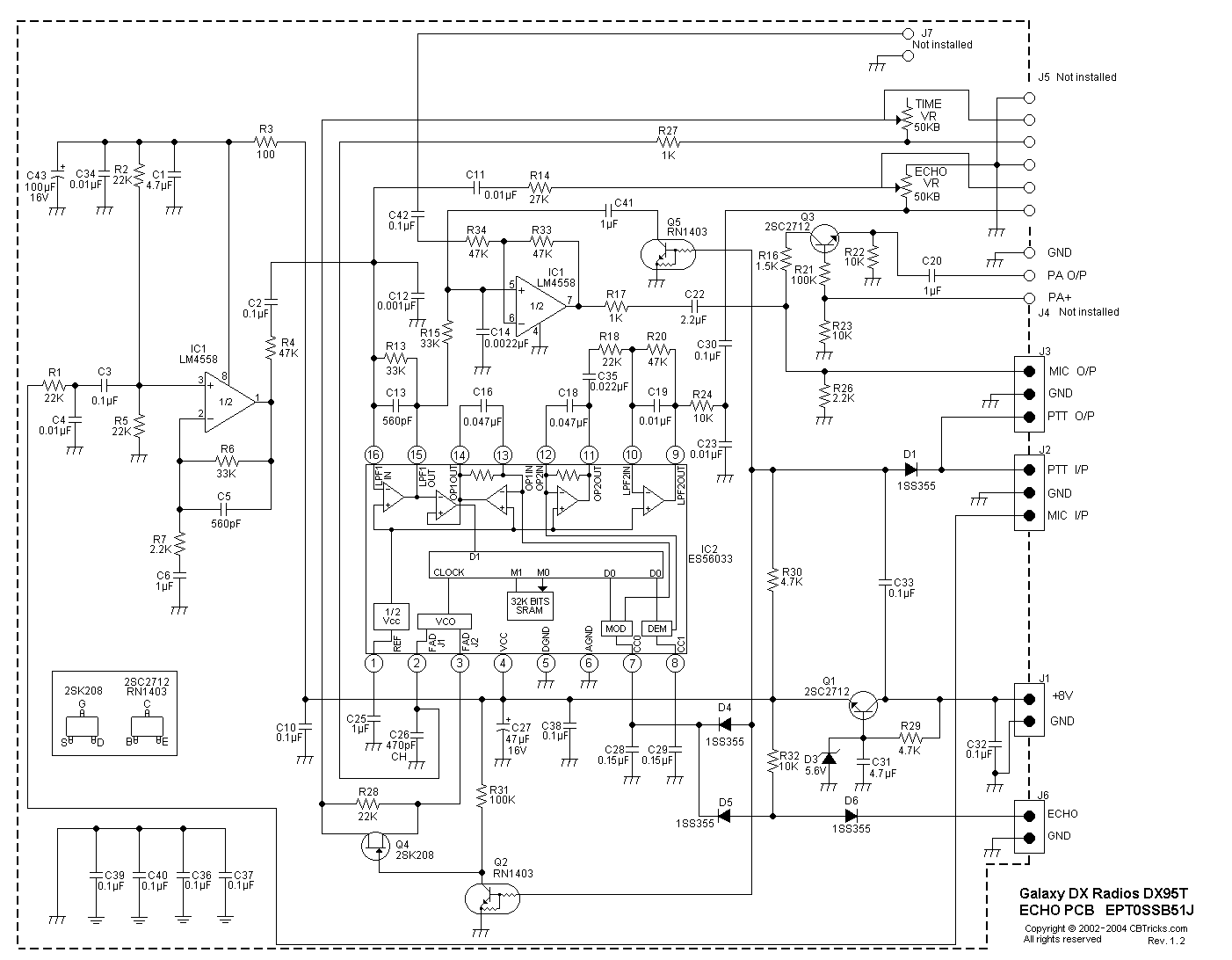

Schematic Diagram
Schematic Diagram
