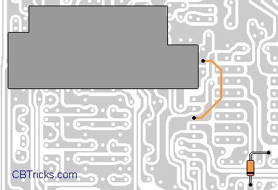

Before Conversion
Shown in stock position
After Conversion
Shown in mod position
Frequency Conversion
1.
Remove the top cover from the unit and locate wire jumper on the bottom of the main pcb. Move the wire from it's current position to the position shown in the drawing above.
