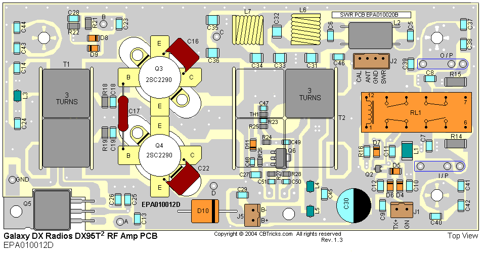

RF AMP PCB (EPA010012D)
Trace Layouts
Copper Side Parts
Schematic
Ref#
Description |
MFR.
Part No.
RF AMP-D1 EPA010012D(DX-95T) |
#T-149B-P08 |
RF AMP P.C.B. 121x58x1.6tmm(S) |
EPA010012D |
