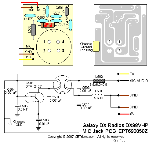

Galaxy
DX Radios DX98VHP
Documentation Project
CBTricks.com
MIC Jack PCB (EPT690050Z)
Ref#
Description |
MFR.
Part No.
MIC JACK PCB EPT690050Z |
#T-141L-P04 |
EPT690050Z |
EPT690050Z |
Capacitors
Ref#
Description |
MFR.
Part No.
C501 |
C/C 0.001UF 50WV SL Z |
CC0501027L |
C502 |
CC0501027L |
C503 |
CC0501027L |
C504 |
CC0501027L |
C505 |
0.01UF 50WV SL Z |
CC0501037L |
C506 |
0.01UF 50WV SL Z |
CC0501037L |
Transistors
Ref#
Description |
MFR.
Part No.
Q501 |
T/R DTA124ES |
TDTA0124ES |
Inductors
Ref#
Description |
MFR.
Part No.
L501 |
CHOKE COIL 5.6UH |
ECCHK16001 |
L502 |
BEAD COIL WBRH-3.5x6x0.8-U10 |
ECBAD18526 |
Connectors
Ref#
Description |
MFR.
Part No.
MIC JACK SCS 16 4(R)� |
��� EX06N41020 |
Ref#
Description |
MFR.
Part No.
MIC-50J(J2) |
WIRE CONNECTOR/H #28L=140 PH=2.5 |
EX07N48903 |
MIC-MAIN(J26) |
WIRE CONNECTOR/H 2P L=100 PH=2 #28 |
EX07N48233 |
Hardware
Ref#
Description |
MFR.
Part No.
SOLDER PLATE L=35mm |
XZZZ90423Z |
