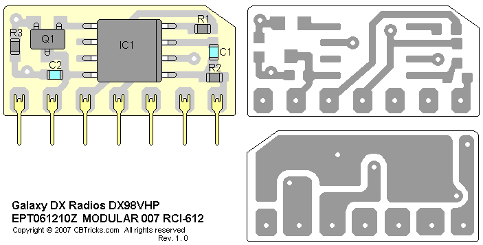

Galaxy
DX Radios DX98VHP
Documentation Project
CBTricks.com
MODULAR
007 RCI-612 (EPT061210Z)
Schematic
Ref#
Description |
MFR.
Part No.
MODULAR 007 |
RCI 612 |
#F007 |
RCI 612 P.C.B 17.78x8.5x1.0t |
EPT061210Z
Resistors
Ref#
Description |
MFR.
Part No.
R1 |
CHIP/F/R (SMD) 10K OHM 5% |
RCY061034Z |
R2 |
CHIP/F/R (SMD) 39K OHM 0.1W |
RCY063934Z |
R3 |
CHIP/F/R (SMD) 2.2K OHM 5% |
RCY062224Z |
Capacitors
Ref#
Description |
MFR.
Part No.
C1 |
CHIP/C 0.1UF 25WV Z Y5V |
CK2104AD7R |
C2 |
CHIP/C 100PF 50WV K CH |
CK1101AD5A |
Integrated Circuits
Ref#
Description |
MFR.
Part No.
IC1 |
I.C. (PHILIPS) (SMD) SA602A 8PIN |
YNPH00602A |
Transistors
Ref#
Description |
MFR.
Part No.
Q1 |
�T/R (SMD) 2SC2714Y-TE85L |
TY2SC2714Z |
Connectors
Ref#
Description |
MFR.
Part No.
IC PIN |
0221.0 S (WAKO) |
GZZZ50098Z |
