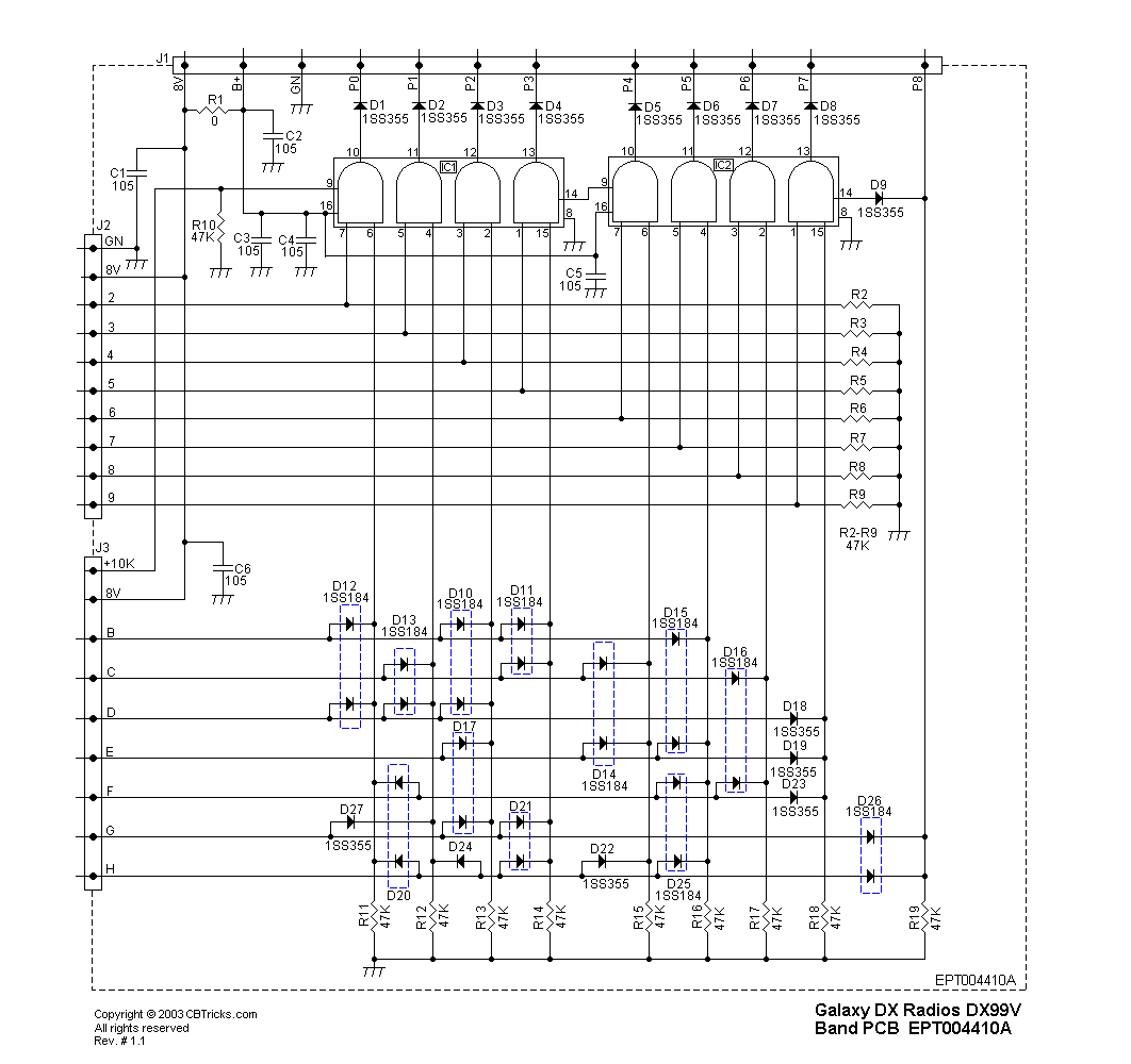

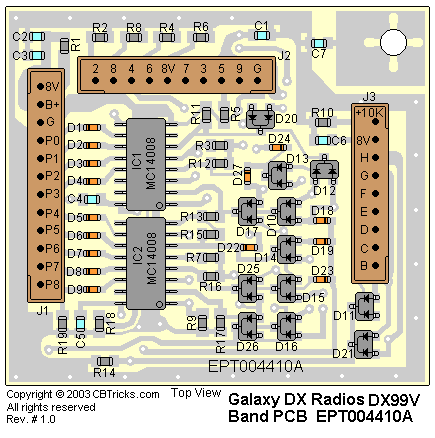

Galaxy
DX Radios DX99V
Band Board Layout (EPT004410A)
Trace Layout
Ref#
Description |
MFR.
Part No.
BAND PCB EPT004410A Complete with Components |
#MM-104T-P06 |
BAND P.C.B. 46x41x1.6tmm(S) |
EPT004410A |
