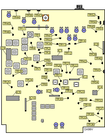

Galaxy DX Radios DX99V
Active Device Location Diagram
TR 1......NB Amp
TR 2......NB Amp
TR 3......NB Amp
TR 4......NB AGC
TR 5......NB Pulse Amp
TR 6......NB Pulse Amp
TR 7......NB Shunt Switch
TR 8......2nd RX Mixer
TR 9......AM/FM IF Amp
TR 10....AM/FM IF Amp
TR 11....AM/FM IF Amp
TR 12....SSB Switch & AGC
TR 13....AM/FM S-Meter
TR 14....SSB/CW S-Meter
TR 15....AF Preamp
TR 16....Squelch Switch
TR 17....RX RF Amp
TR 18....1st RX Mixer
TR 19....1st SSB IF Amp
TR 20....2nd SSB IF Amp
TR 21....3rd SSB IF Amp
TR 22....4th SSB IF Amp
TR 23....AM Det. Switch
TR 24....PLL Ref. Osc.
TR 25....VCO
TR 26....VCO Buffer
TR 30....Carrier Osc.
TR 31....SSB Switch
TR 32....AMC Shunt
TR 33....Roger Beep Osc.
TR 34....AMC/ALC Amp
TR 36....RX Voltage Switch
TR 37....RX Voltage Switch
TR 38....TX Voltage Switch
TR 39....Talkback Switch
TR 40....Voltage Reg.
TR 41....Voltage Reg.
TR 42....AF Preamp
TR 43....RF Final Amp
TR 44....RF Driver Amp
TR 45....RF Predriver Amp
TR 46....RF Amp And Buffer
TR 47....ALC Sense Amp
TR 49....AM Mod. Amp
TR 50....AM Mod. Amp
TR 51....AM Mod. Amp
TR 52....SSB Switch
TR 53....AMC Amp
TR 56....RF Final Amp
IC 1......Squelch & AGC Amp
IC 2......FM Det.
IC 3......Balance Mod.
IC 4......Mike Amp & TR Switch
IC 5......PLL Synth.
IC 8
......Audio Power Amp
IC 9......TX Mixer
IC 10....PLL Mixer
