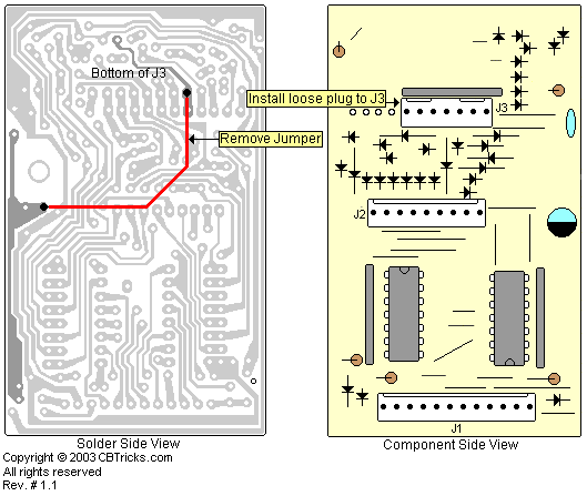

Remove the bottom cover from the unit and locate the Band PCB EPT004410Z on the left side of the radio. Remove the screw holding the board and plug in the loose connector J3 on the component side as shown above.
2. Unsolder and remove the short jumper wire on the solder side of the Band PCB, and re-mount the board back in place. The radio will now work from 25.165MHz - 28.755MHz
