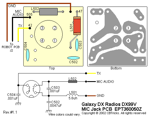

Galaxy DX Radios DX99V
Mic Jack PCB (EPT360050Z)
Ref#
Description
MFR. Part No.
MIC P.C.B. EPT360050Z Complete with Components
#MT-101-P05
MIC P.C.B. 25x25x1.6tmm
EPT360050Z
Capacitors
Ref#
Description
MFR. Part No.
C502
C/C 0.0047UF 50WV SL Z
CC0504727L
C503
C/C 0.001UF 50WV SL Z
CC0501027L
C504
CC0501027L
Inductors
Ref#
Description
MFR. Part No.
L501
CHOKE COIL 5.6UH
ECCHK16001
L502
BEAD COIL 3.5X6X1.2 PH=12.5
ECBAD18550
Connectors
Ref#
Description
MFR. Part No.
MIC JACK SCS-16-4(R)
EX06N41020
