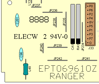

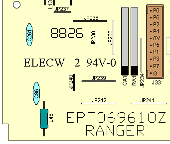

Galaxy DX Radios EPT069610Z Notes:
In doing this I have made a few notes you may find of interest.
There will be updates to this section as I get along wth this project, so check back.
One version of this PCB there is two places marked as JP172 at grid location E4
and two places marked as JP160 at grid location E4
The PCB have the following markings.
This PCB has JP243 marked as JP243
This PCB has JP244 marked as JP244
This PCB has JP243 marked as JP172
This PCB has JP244 marked as JP160
The EPT092913Z layout drawing and parts list on this site will show this as JP243.
