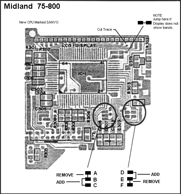

1. Remove the case and locate the points ABC & DEF as shown in the diagram.
2. Unsolder the points at locations AB & EF, and solder the points BC & DE instead.
3.The unit should now operate on the expanded bands. The LCD display will indicate which band is in use by the designations shown below.
4. The channel 9 button is used for changing band operation.
