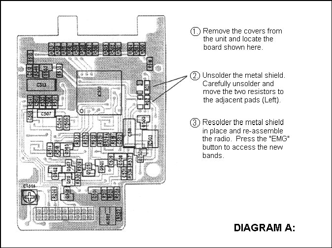

1. Remove the bottom covers from the unit and locate the Microprocessor circuit board as shown above. Remember to remove the screws inside the battery compartment before prying the unit apart.
2. Unsolder and move the two small chip resistors to the adjacent positions just left of their current position. These Zero Ohm resistors are easily damaged so be sure to use a low wattage variable temperature soldering iron for the job.
3. Re-assemble the unit and use the "EMG" button to change bands.
Note: Bands are indicated by a small dot in the upper (HI) or Lower (LO) display window.
