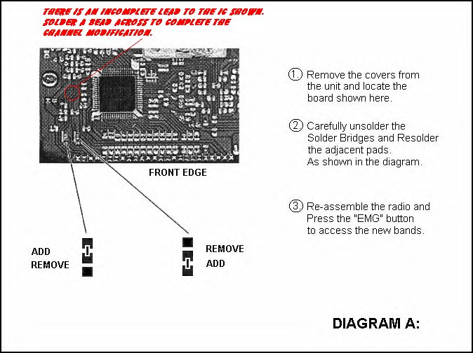

1. Remove the bottom covers from the unit and locate the Microprocessor in the left front corner of the circuit board.
2. Unsolder the two small solder bridges on the pads shown in Diagram A and re-solder the adjacent pads as shown
3. Re-assemble the unit and use the "EMG" button to change bands.
graphics/NOTE.gif
NOTE: Bands are indicated by a small symbol in the Upper (+) or Lower (-) Left side of the display window.
