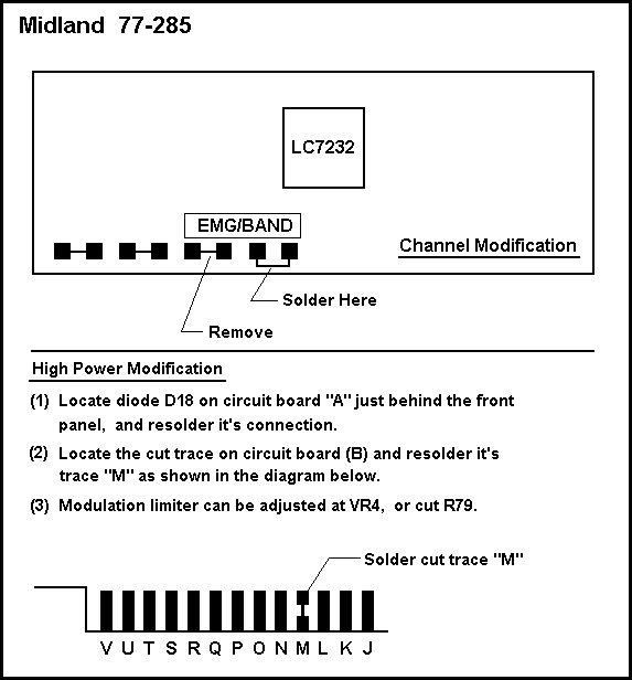

Export Frequency Conversion
1.Remove the case from the unit and locate the terminals on the circuit board labeled EMG/BAND.
2. Remove the solder from terminals marked EMG, and solder across the terminals marked band.
3. The unit should now operate on the expanded bands. A small arrow indicator will designate the band of operation.
4. The channel 19 button is used for changing band operation.
