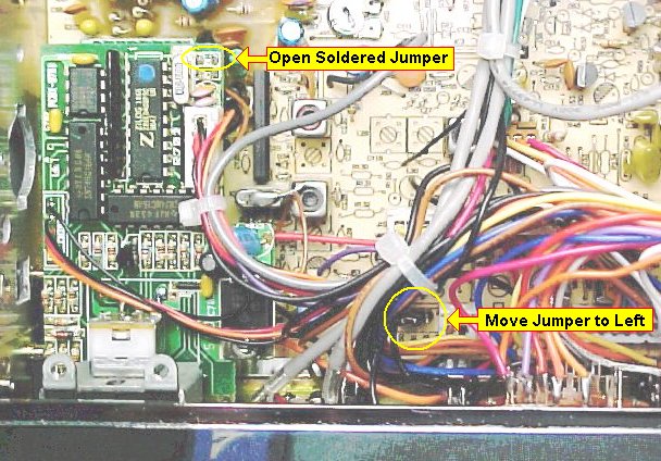

4.
With radio open, knobs facing you, locate the frequency board in lower left section of chassis.
On the top right of the frequency board, there are two soldered jumpers next to the CQ8.0000 crystal.
Open the jumper furthest from you.
5.
Locate J106 directly behind the echo control, (3 pins with a jumper on the right pair). Move the jumper to the left pair of pins.This completes the frequency conversion.
6.
Apply Power and check out the radio for proper operation and do or check alignment if necessary.
