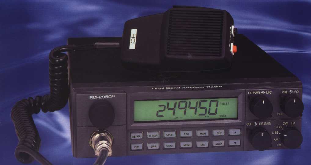

Ranger RCI-2950DX
Click picture to see close-up

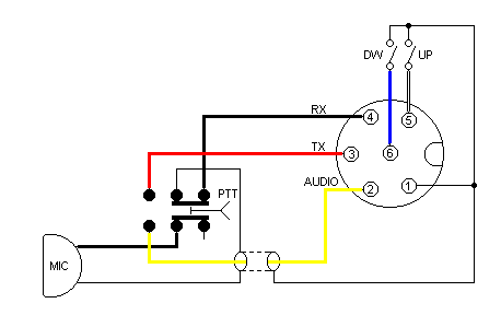

Mic Wiring Info
Stock Mic Wiring
1. Ground Shield
2. Audio Yellow
3. Transmit Red
4. Receive Black
5. CH. Up White
6. CH. Down Blue
