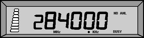

23. LCD DISPLAY:
The LCD displays the frequency selected, functions and memory channel.
