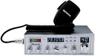

Ranger (Superstar) SS-158EDX
Picture Tour of the Radio
Click Picture to see close-up
