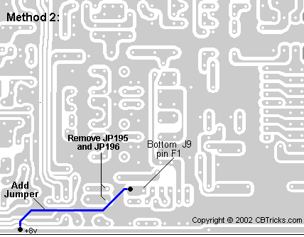

Method 2:
1.
First, remove power to the radio. Remove the bottom chassis cover of the radio.
2.
Remove JP195 and JP196.
3.
Connect a jumper wire between +8V and J9 pin F1.
4.
Perform an PLL alignment as shown below.
