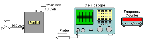

PLL Alignment Procedure
Refer to ALIGNMENT POINTS
Test Equipment required
a. Oscilloscope (DC - 50 MHz)
b. Frequency Counter (0 - 30 MHz)
c. DC Power Supply d. 50 ohm Load
