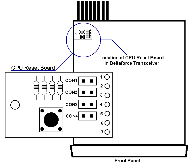

2. | Take off speaker-side cabinet. |
3. | Find the CPU Reset Board located near the rear panel of the radio (see diagram below). |
4. |
On the CPU Reset Board are 4 jumper positions (CON-1 - CON4). Each jumper position provides a different frequency range and configuration. From the list below, select the desired frequency range and configuration, and move the jumper shunt to the corresponding CON. |

5.
After selecting the desired frequency range and configuration, press the CPU Reset Switch (SW1) for 5 - 10 seconds. |
6.
Reassemble
the radio, turn on and test. |
