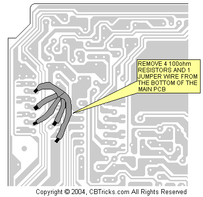

1.
Remove the 4 resistors and jumper wire from the bottom of the main PCB. The resistors and jumper wire are inside protective sheathing.
2. After modification BAND "D" is the regular 40 channel CB band.
