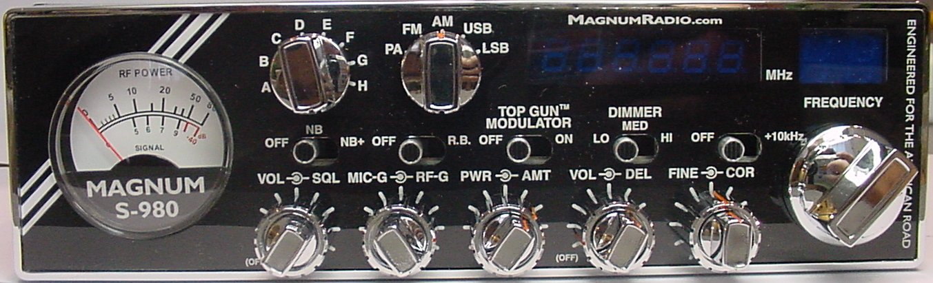

Picture Of the S980 (2008 Version)
Magmun S-980
Click Picture to see Close-up
