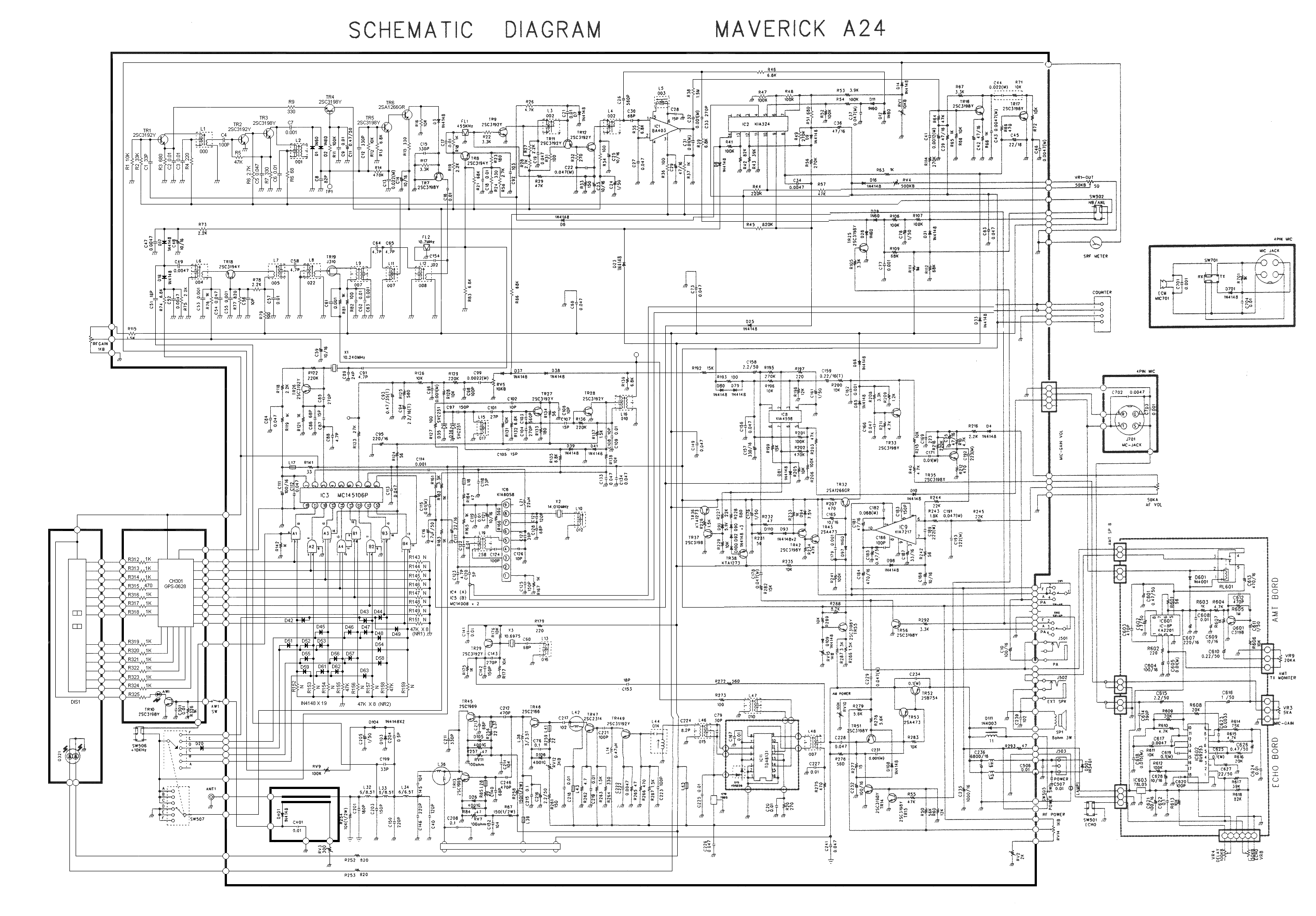

DIAGRAMS
    A24 Schematic Diagram

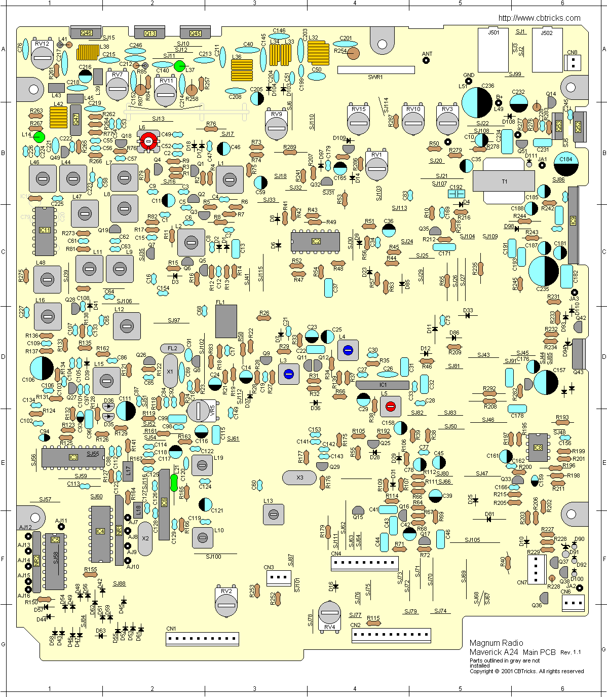

PCB Layouts and Parts
    Main PCB Layout
    Main PCB Scan of the bottom
