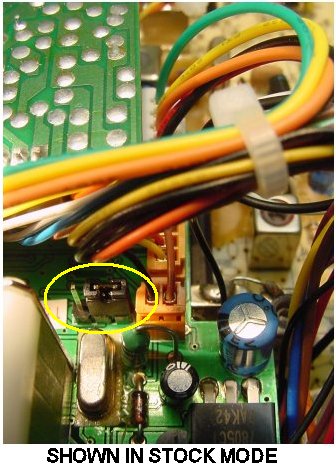

All that is needed for the frequency conversion is the movement of the jumper circled in yellow in the above picture. (Jumper is on the channel selector PCB)
This jumper fits on two of the three pins that are in a row.
Move the jumper so it sits on the left and center pins instead of the right and center pins.
5.
