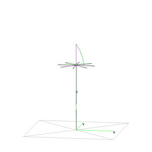

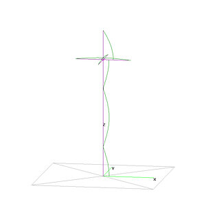

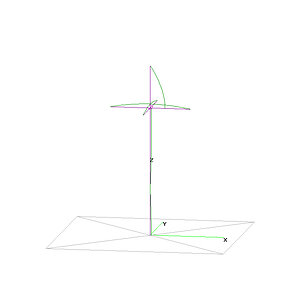

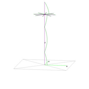

Elevated radials and decoupling
Do elevated radials decouple currents on the mast better?
I modeled a 1/4 wavelength antenna at two heights with both 4 and 8 radials to see if there is a difference.
