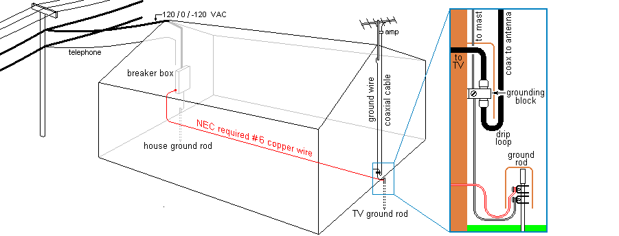

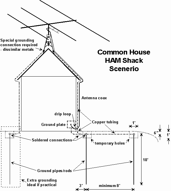

To ground your antenna for safety there is tons of info on the internet.
