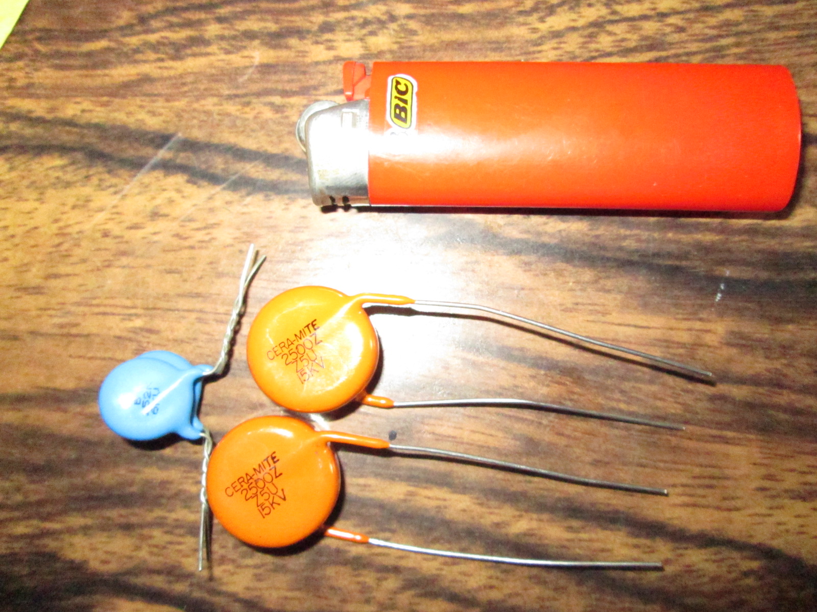

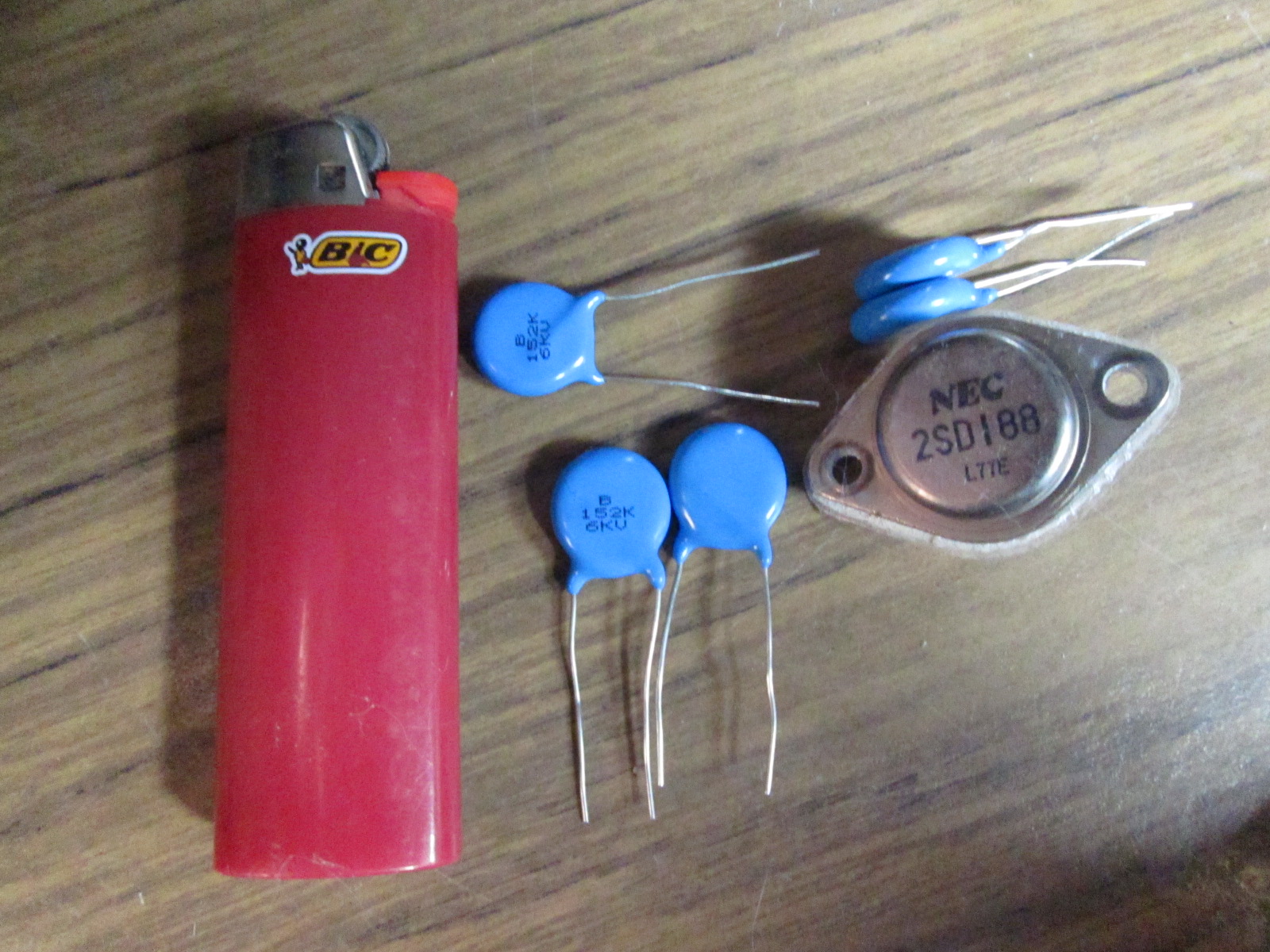

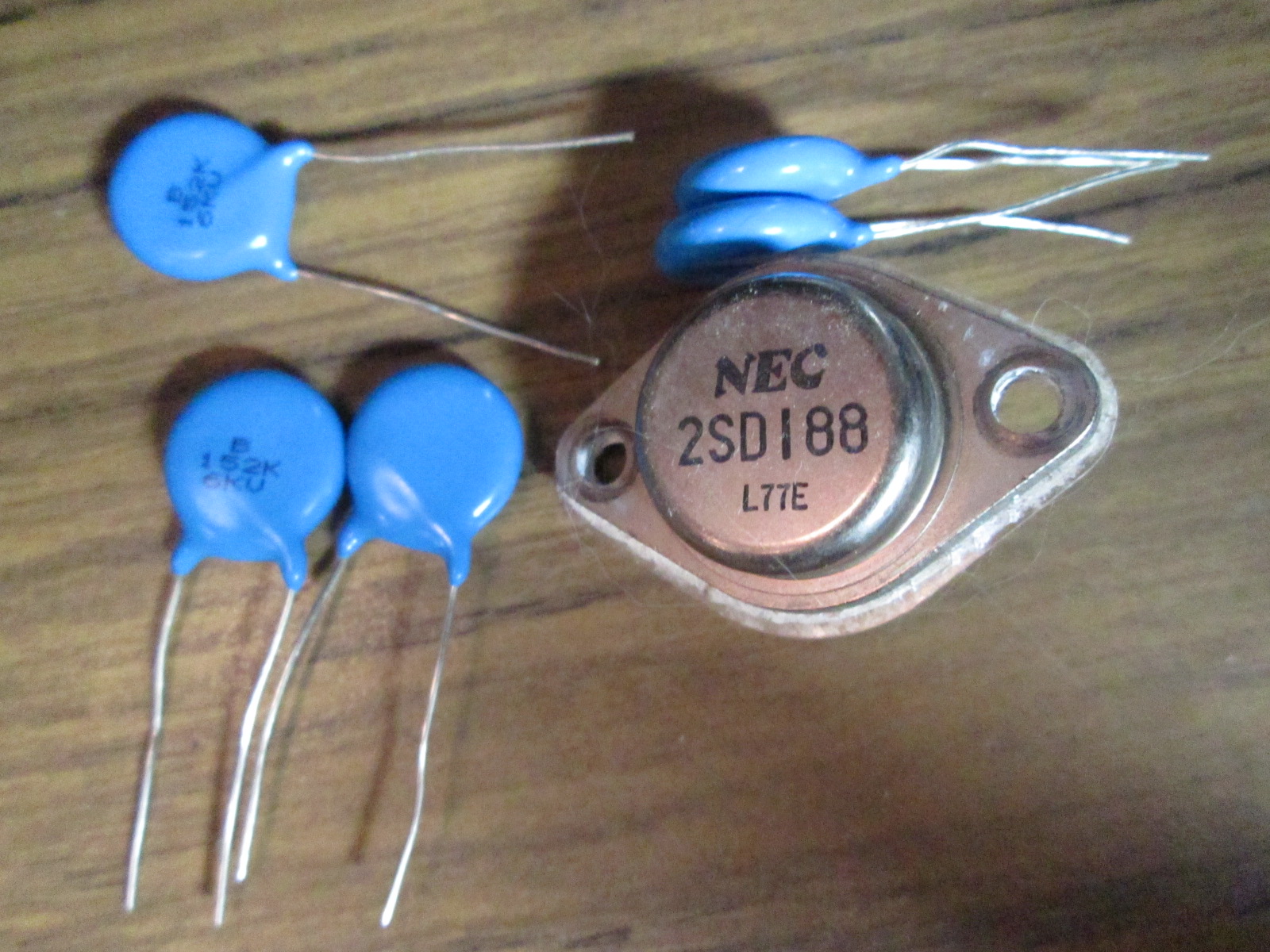

These are supposed to be 6KV but they look small.
Manufacturer: RFE international
Part Number: 2YP152K602A97
Capacitance (uF): 1500
Voltage: 6000
Tolerance (%): 10
Mounting: Through Hole
Lead/Terminal Type: Radial
Number Leads/Terminals: 2
Material: Ceramic
Color: Blue
Temperature: 85
RoHS Compliant: Yes
Shape: Round
Termination Method: Solder
They do look a little small but it depends on their current rating too. I have some 6 Kv that are about the size of a quarter and some 4 Kv smaller than a dime. Also I think that value is supposed to be 1500 pF not uF.
