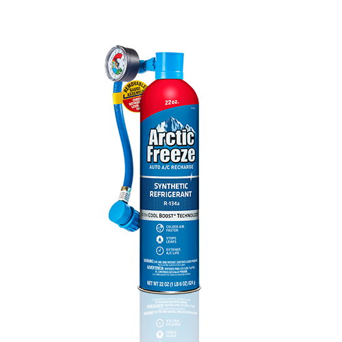

Got tired of the seemingly poor AC in the little truck. Put on my refrigeration gauges and sure enough it was low on freon. I wasn't expecting a problem really as the truck only had 35K miles on it when I inherited and all else was well maintained and like new. Got one of these and it fixed me right up. AC is blowing COLD. So YES, the AC in a modern small standard cab GM truck should be just as cold as what you get in a larger vehicle.
