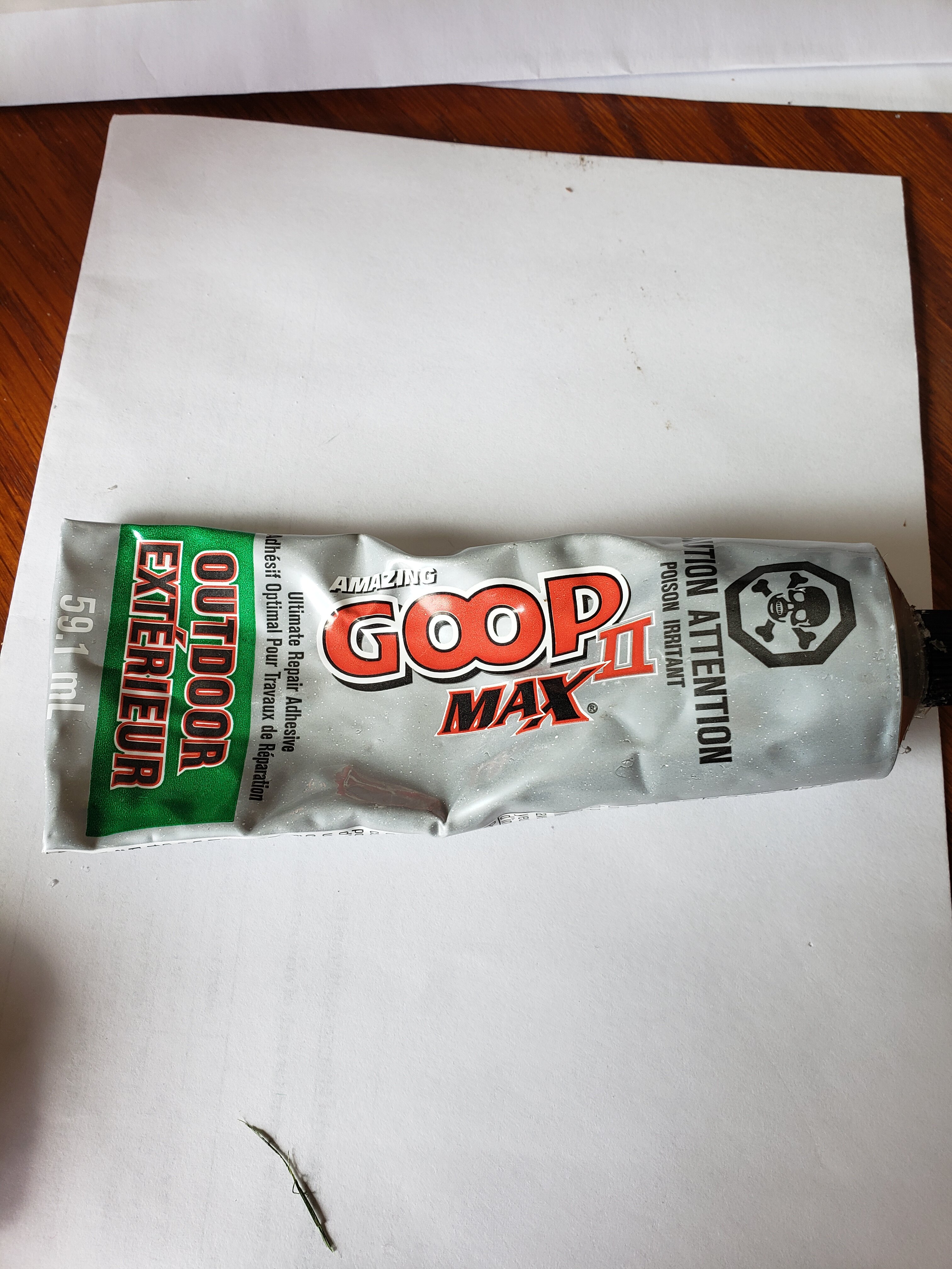

I use this stuff. Seals like a mutha as well. Uv protected, stays flexible and easy to peel of when needed. Its awesome.
