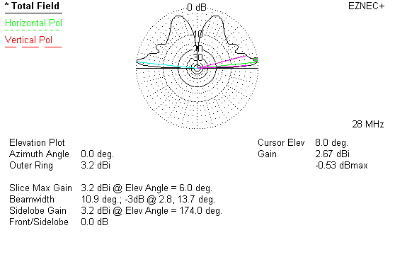

Even if we use the optimum feed line and mast length, here is the very best the end-fed vertical antenna will do is this pattern.
In this case we now have 2.67 dBi at 8 degrees elevation. This is actually an amount that is unnoticeably less than a perfect 1/4wl ground plane will produce! These severe common-mode mast and feed line currents make "no-radial" verticals extremely sensitive to mounting height, mounting structure, feed line length, and grounding. CB'ers for example often talk about grounding coax or changing coax length to match an antenna. If changes in mast length or feed line length or grounding affect the antenna pattern or SWR, it is an antenna design problem.
The gain over a dipole is now a few db at some really low angles, so it can be better than a dipole. At slightly higher angles for shorter skip, the dipole takes over and can be several dB better than the vertical.
This change is entirely the result of altering height and feed line/mast length!!! No antenna changes were made!"
