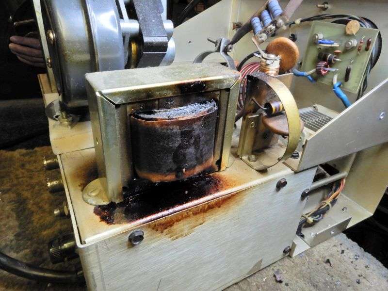

Always check under the hood before getting serious with the money.
This guy was not pleased with the repair estimate.
At least now he knows why we call a 30-Amp fuse a "No-Blow" fuse. The 15 or 20 Amp breaker that feeds the wall outlet will trip first.
The big transformer was okay, still had high voltage to the anode circuit.
The small one wasn't cheap when RF Parts had it, but they sold out years ago. Pretty sure I got the last one of these. Went into a Pride that lives in shaky-land now. Nearest Hammond part is a bit bigger, but can be made to fit. For around $130 bucks. Add even a modest markup and shipping cost to that and the price of that smoke gets impressive.
We use a cheaper toroid transformer, but getting it mounted and wired up is labor intensive. The low-voltage board has to be modified to work with it. Bottom line ends up less than the Hammond option, but not by a lot.
I won't so much as lay hands on one of these to fix it without adding a 1-Amp breaker to that small transformer. Don't want my name associated with seeing one of them get croaked. Roaching a part made from unobtanium is just bad juju.
Guy put in a “new” tube.
A new one his buddy found cleaning out his garage? This scenario comes up over and over. I tell them there's good news and bad news. The good news is that you successfully tested and found a bad tube.
The bad news is you successfully tested and found a bad tube.

Well the “ new tube” was bad too. Popped another electrolytic capacitor. This ones getting a 350V MOV and a 1/4 W 47ohm resistor going to screen. I will do like you said and put a 1A fuse inline with transformer. This amp has all the old original boards. Might be calling Chris for new boards. As I’m sure they have more protection built into boards than original that had nothing.
