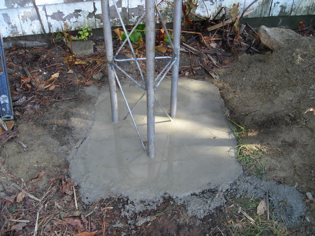

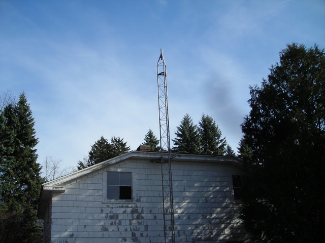

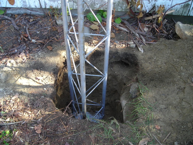

Well here is another Satellite Station in the process of being set up.
Dave, my SAT Elmer, is in the process of getting his station back together and I spent the morning with him erecting a tower.
He Picked up a 40' Rohn 25 Tower for $100, Great Price and the tower is in nice shape.

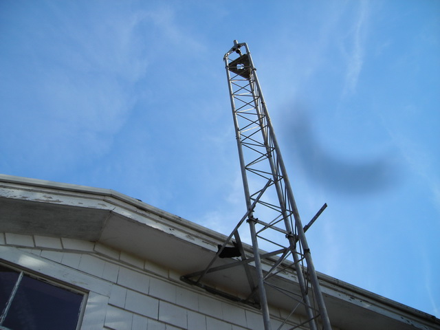

The nice thing about Satellite setups is that they dont have to be too high up, you just need to get high enough to clear obstacles. Daves setup should work pretty well he has some tree's to the north that might be a problem on low passes but he will still be able to work them for most of the pass.
Hopefully we will get his rotator and antennas up today or tomorrow, he doesnt have any excuses now hehehe he has been off the air for a while since they just moved into the farm.
I'll post up more pictures when we get the rest of the stuff up in the air, he has a nice Gulf Alpha antenna array.

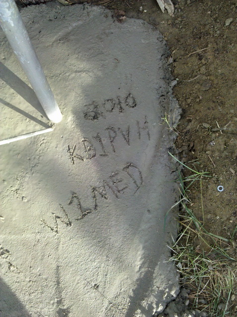

I even got some credit with my callsign in the concrete ..
Great job looks good and solid. In a few days when the crete dries then the fun/work starts installing the antennas and rotor.

Actually its all set right now, Dave called me this morning and he was wiring up his G-5400B Rotator and should be picking up a cross boom tonight.
Tomorrow I will probably go over and help him with the antenna's.
I found a Great cross boom for the Yaesu Rotators. Its a 1.25" Schedule 40 PVC Pipe, it fits perfectly in the rotator, then you add a wooden closet hanger dowel, it fits a touch loose inside the PCV but when you tighten up the clamps its perfect, and is real sturdy. I sprayed mine with some clear UV protectant paint so I should get plenty of life out of it.
